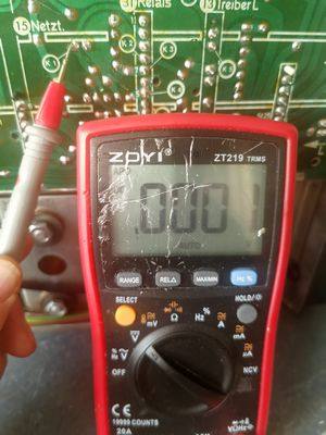

      Today I checked the power supply again and found that the power supply is unstable, sometimes there is no DC 15v of K1.
      Look at the voltage at several locations of the power supply,
      K1 has no voltage after several measurements:
      I unplugged the LED connection board, the LED light still flashed.

      ok.
      The flashing remote control indication LED has nothing to do with the plug you pulled.
      The voltages you measured are ok. Except your statement that you don't have consistent measurement at K1. However, because we don't know how you measured at K1 and what you had switched before (i.e., did you switch the unit off before, or did you push a program button and did the remote-LED still flash when you could not measure any voltage at K1 ?), no comment or conclusion is possible yet.
      Next point is checking the switching transistor T636 and checking range indication module 62. However, that may be difficult for you. It is much easier to swap modules No. 66 (FS.power-module)and module no. 62 with the ones from your other working 9141 receiver.
      Can you tell if your other("good") 9141 receiver is working ok with module 66 and module 62 from your faulty receiver?

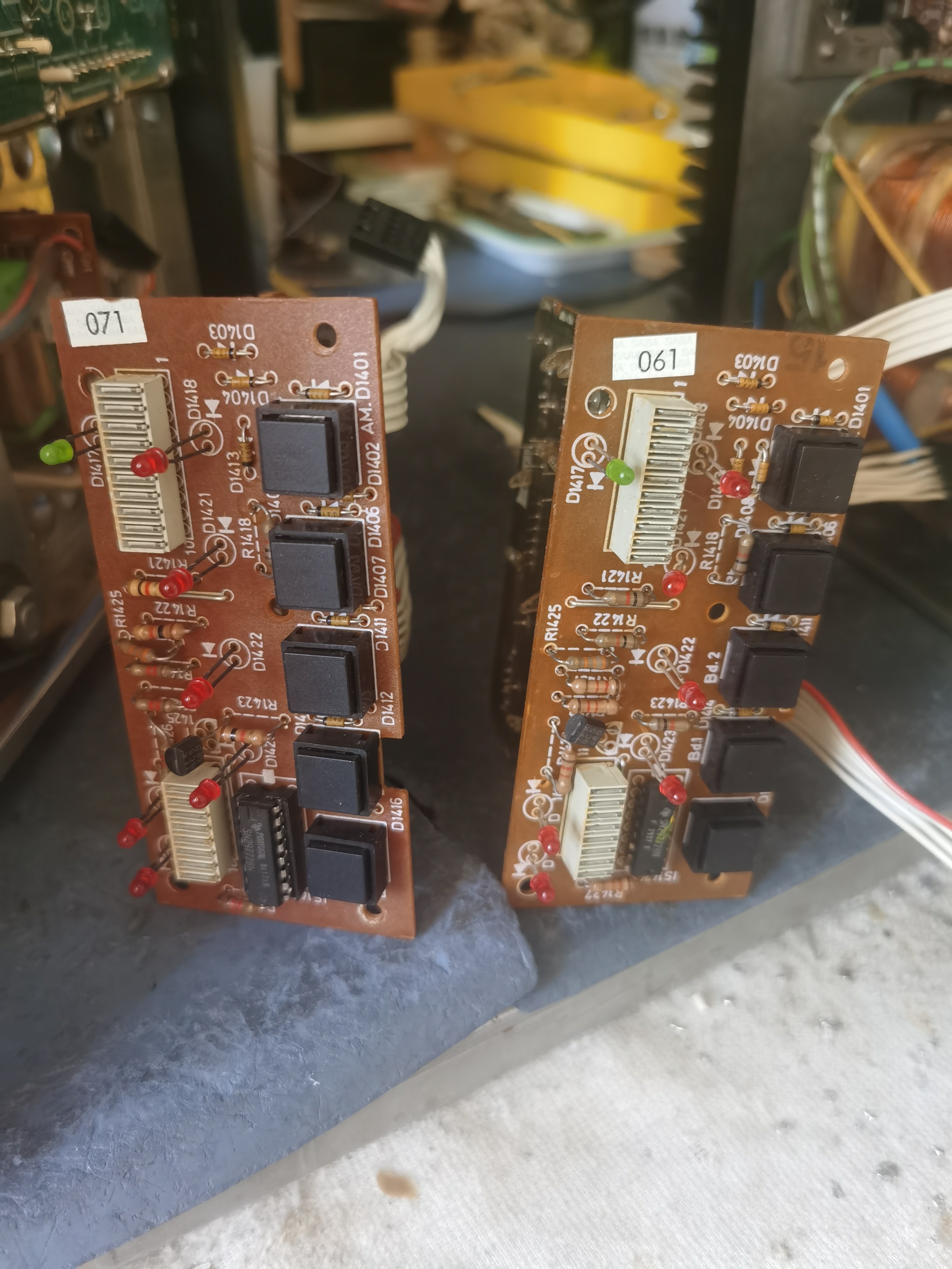

      Hello, teachers, let me report on the maintenance situation in the past few days:
      1. For several days in a row, I insisted on looking for the fault according to the instructions of the teacher, and I never found the cause of the fault, and the fault still exists.
      At the same time, I turned on another 9141, compared the search, replaced it with the replacement method, but couldn't find the fault. I was desperate, and I had the idea of giving up.
      2. Finally, I came to the 9 terminals of the connection board of No. 66, No. 60, No. 63 and Buchsenplatte No. 7701303600 power supply board again. I measured the voltage with a multimeter and found that the voltage of terminal 8 was abnormal. The reason why the voltage is not normal. Finally, I checked the soldering points of the small motherboard and found out the reason. A friend who was repaired at home, the fault was caused by the wrong welding. I found the correct motherboard for comparison and confirmed that this is the problem.
      3. I removed the wrong welding from my previous home, connected the machine, and started it normally.
      4. At this time, I found that there is still a small problem. The volume button LED does not display. I turned on the small motherboard at the back and found that the resistance was broken. After replacing it, it returned to normal.
      I am very happy and happy. Thank you for your patience and guidance. It is your patience that gave me confidence. Thanks again to the teachers and best wishes for you.

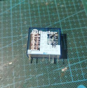

      Hi wyx12007cba, hi to all,
      yes, I could help with two platines if it is urgently. One type is designed to replace the relay on the power module, the other type enables the exchange of the relay on the relay module. This platine has to be fitted additionally with an inductor/ resistor combination for the outputs. Both work with common print relays, footprint as attached.
      But I do not plan to offer them here on regular base. Tommy's solution was first and it works perfectly according to Michael. So I do not want to start some kind of second offer here.
      wyx12007cba, if you would like to have such platines, please contact me via PM. But they will come without parts. I can only supply the platines.
      For one receiver 9241 or 9260 you have to order in your home country:
      2 relays, 12 V, 2 x form c contacts, 8 Ampere
      2 inductors 2.2µH, 5 mm pinning
      2 resistors 2.2 ohms, 1 watt
      2 diodes 1N4001 or similar
