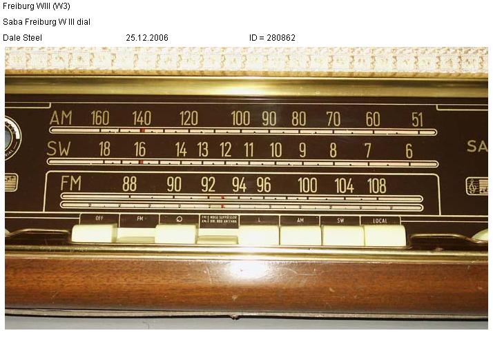

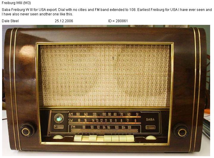

      Another puzzling observation here....Both my Freiburg WIII and this model 3DS receive the complete UKW band through 108 mhz. Both radios are equipped with the normal "domestic" (for use in Europe) glass dial scales with UKW only to 100 mhz- as I would expect for radios of this vintage..
      There are no signs of nachbau (after factory) modifications or adjustments having been made to the Vorstufe tuning rods in either of these radios.
      I do realize that the firm Saba did export at least the model WIII to North America, as Radiomuseum member (American) Dale Steel shows a "thumbnail" photo of an export WIII on his member page only, which clearly shows the export variant dial scale. I have never seen any other examples of this export model WIII .
      I could attribute this oddity of having a radio equipped with the domestic European scale and a tuning range to 108 Mhz if possibly the original "export" scale had been damaged and subsequently replaced with an available "domestic" scale, but the chance of owning _two_ early Saba models with both having the modern UKW tuning range and both showing the domestic (Euro) dial scales- and both Rueckwand having graphics in German?

      Yes Heiner, that photo shows the same dialscale of the model WIII from the collection photos of Dale Steel that I mentioned above. Thank you for downloading and posting it here for all to view. At one time, I was unable to open that collection photo, though I am a valid member of RMorg. Possibly it was just a temporary problem for me then?
      What are the chances of knowing that four- (2X WIII and 2X 3DS) radios residing in North America showing the "domestic" European scales, but equipped otherwise for the "export to North America" modifications?
      Might all four radios I mentioned have had "domestic" scales to replace "export" scales sometime in their existence, or may there have been a possibility that Saba produced some of the units destined for "export" and let them leave the factory production with "domestic" scales attached?
      For now, I will be content to keep the more attractive "domestic" scales with my radios, in spite of not having a calibrated UKW band. I consider myself fortunate to be able to possess these fine radios.--Either way! :D
      I will just consider the expanded UKW band as a positive variant.
