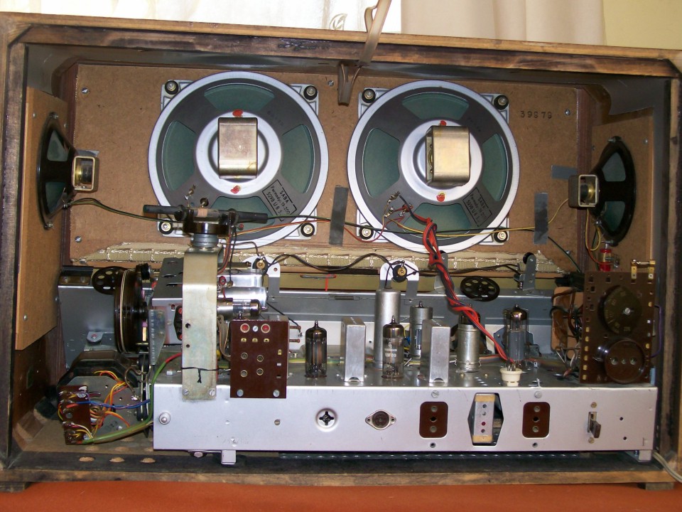

      Hello,
      today I was finally able to take some pictures, as good weather and free time finally met. The device is working great, although there's still a little problem with automatic - it finds more stations going from right to left than the other way.
