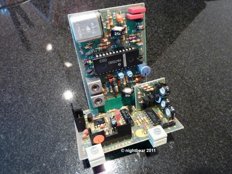

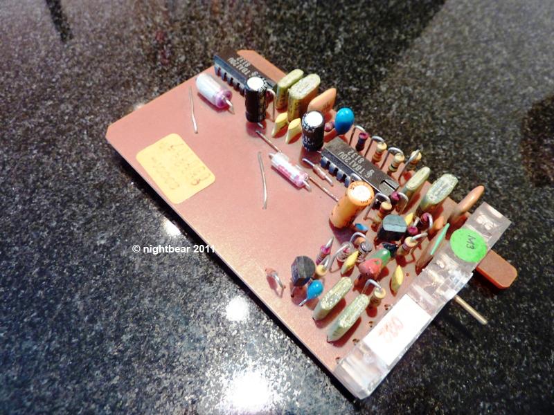

I´m going to schow some hardware now that was used back in the heydays of conversion:
First here´s a sound IF unit for 4.5 and 5.5 MHz. You can see a little oscillator running @ 1 MHz to get the right frequency by mixing.
This device can be used universally and replaces the ceramic filter in the set:
GRUNDIG made some sound IF cards that could be swapped for the built in cards for reception of both 4.5 and 5.5 sound - as you can see they used two seperate sound IF amplifiers. This is the point of bliss as far as dual sound quality is concerned!

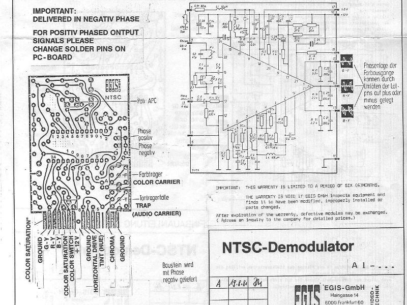

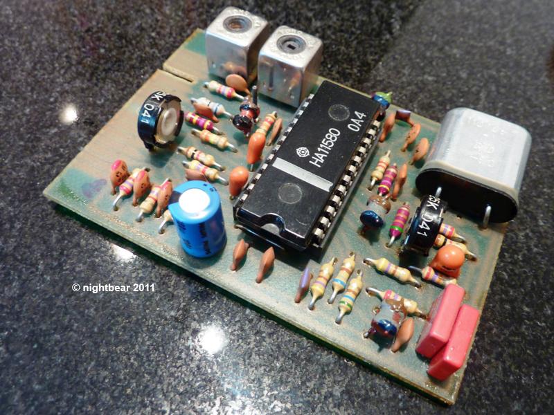

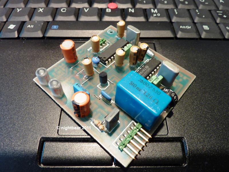

Next you see an EGIS NTSC decoder card. It could be used with a custom-made socket to fit any TV chassis or model:
and here´s a complete unit - I´m not sure for which model though...
NTSC decoders are my favourite solutions to enable multi-standard colour as you now know. But, they are not always an option.

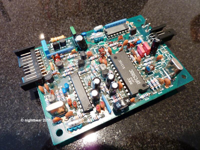

Next is an NTSC-transcoder. A little bit easier to fit in and for some TV models the only way for NTSC reception. They only provide a decreased colour quality - I used those when I was in a hurry or if the customer didn´t care about quality:

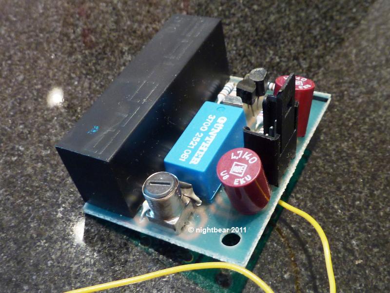

here´s a cheap transcoder made by Sectronic:
When you use transcoders there´s going to be a runtime lag between luminance and chrominance, so an additional delay line for luminance is needed!
Here it is:

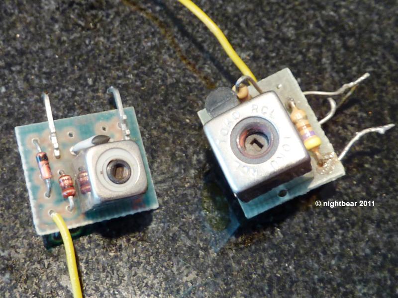

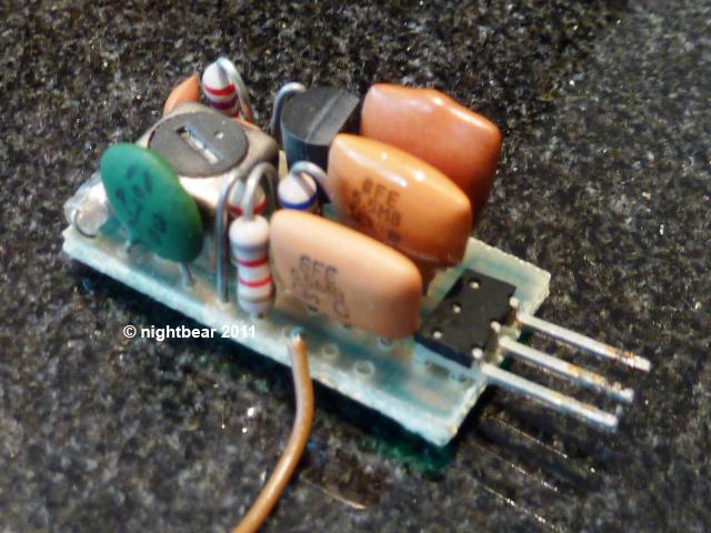

Finally a picture of some colour-carrier-traps:
Just for the record: When everything is done right the picture quality of the NTSC picture is at least (!) as good as PAL. Sometimes it was even a little better. Remember NTSC has full colour resolution, the information is different in every single line while PAL uses two lines as one sharing the same information. There are some more ponits that could be mentioned here...
