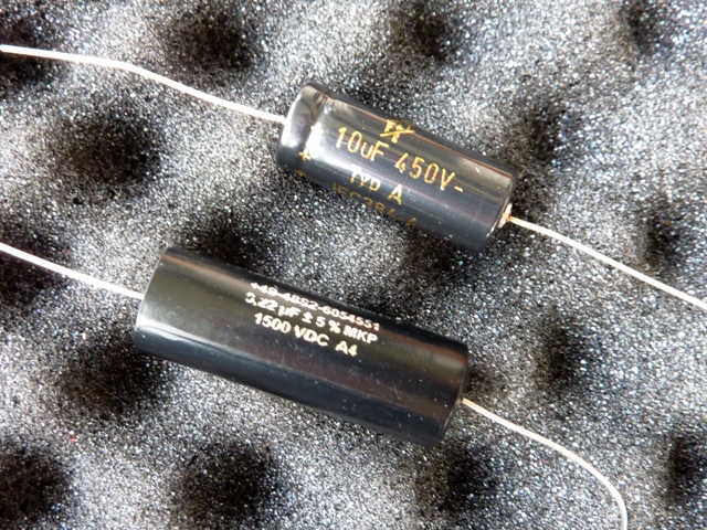

      Hi Omer,
      I can recommend these caps.
      They are made by Fischer & Tausche in Kiel, Germany and get relabeled by Jan Wüsten for his own distribution.
      If you are looking for the highest quality - search no more.
      Unfortunately - as always - quality has it´s price. This is why many people here prefer the yellow capacitors (made ich China) for their everyday projects.
      Personally I think it depends on the radio you want to use them for and on how much you want to spend.
      If you´re not on a budget and intend to repair a SABA Freiburg I´d recommend the F&Ts. If you´re going to repair a Wildbad for use in the kitchen - why not fit in the Chinese caps.
      Just to make it clear - your radio will play alright no matter which capacitor brand you decide to use.
      If you use New Old Stock capacitors however, you can´t be sure if they are fully functional and if they still meet their old spacifications.

      Hello Omer,
      maybe there was a misunderstanding. The capacitors you linked in your first post are good to restore old radios. They are of good quality, have good electrical properties and match optically perfect in an old radio. Achim replied that Mr. Wuesten does not make this capacitors by his own, they are made by Fischer & Tausche (F&T) and specially labeled with this typical black cover. Since F&T is a manufacturer and not a distributor you can not buy small quantities there.
      As Achim wrote, if you don't care about the visual appearance of changed parts and you don't want to spend much money you can take the cheaper metallic film capacitors with axial connection (usually yellow) which are made in China. Technically also metallic film capacitors with radial connectors would work, but they have very short pins and are uncomfortable to install in free wired circuits.

      As a matter of fact there are only a handful of manufacturers of axial capacitors left today.
      So if you want to use new components that are currently being produced - and I would recommend to do so - there´s only a small number of sources to choose from.
      There are basicaly four "ideologies" present in this board:
      Number 1: Only use New (or used) Old Stock capacitors. We´re not dealing with this here - it´s very few people anyway.
      Number 2: Use "WIMA MKS" capacitors. They are widely available and of superb quality but they are radial. This is no problem since you can extend one leg with a piece of wire. From an aesthetic point of view it´s not perfect of course. Some members here use this method and when it´s done carefully it´s a fine solution.
      Number 3: Use the widely available Chinese "CBB20" (and it´s derivates) axial capacitors.
      http://csdsz888.en.made-in-china.com/product/PMGniZgyfVhw/China-Axial-Type-Matellized-Film-Capacitor-CBB20-CL20-.html
      This is indeed the model most people are using here. The Pros are cheap price and axial lineout.
      (note they even didn´t manage to put the wire at the center here)
      Number 4: Use the capacitors by Fischer & Tausche. Their quality is superior, they are still "made in Germany" and they make a very authentic optical impression when used in the older SABA radios.
      http://www.ftcap.de/seiten/de/home/home.php
      There´s a handful of people here who use them.
      As commonly known here I prefer this brand since for me 50ies SABA radios and Chinese firecrackers don´t mix very well.
      Components made in Asia weren´t introduced here before the 70ies (late 60ies). Thats why I use Chinese electrolytic capacitors today when repairing 70ies HiFi components but as long as axial capacitors are produced in this country I prefer them for use in the old tube-radios. Why not help the Guys in Kiel keep their jobs anyway ;)
