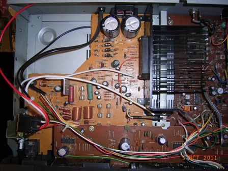

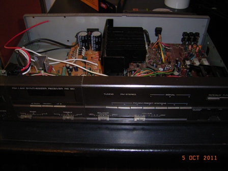

But did i get you right - there isn't a transformer in your set? Did anyone try to repair it already? So by chances there is a lot more to repair. Anyway it will not be so easy to get the right transformer for the set. The values (voltage and current) have to be correct...
Can you describe what's missing - probably post a picture?Gruß, Gunnar -
Up to now i still have no idea how to get the correct transformer for your RS90 without a service manual.
The inside looks like any typical Sony, Technics,... unit from the 80's, but we don't know by now if there has to be one balanced voltage or 2 coming from the transformer.
Perhaps you can buy a service manual, but this depends on the value the reciever represents for you. A transformer with about 120-150 watts (i don't think it will have to supply more power) will cost about 30 - 50 euros, depending on the neccessary voltages it has to deliver.
Now it's up to you to decide how much you like to invest in the reciever...Gruß, Gunnar -
