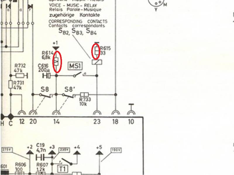

OK - I have located the S/M relay - here it is:
http://saba-forum.dl2jas.com/bildupload/P1010348%20(Medium).JPG
R615 (33 ohms) is the black tubular wirewound resistor and R614 (6.8Kohms) is the white component in the foreground. Both have been removed and test OK.
I cannot locate the elusive ("schwer fassbar" in German - I think!) C616 - the 200uF electrolytic. If anybody knows where it is located on this chassis, I would be most grateful!
Otherwise - and this is my next step - I will have to unsolder the relay unit and clean and lubricate it.
But - I don't think the relay is receiving any power when the S/M button is pressed. I have cleaned the contact on the button itself.
Any more ideas please??
Bryan

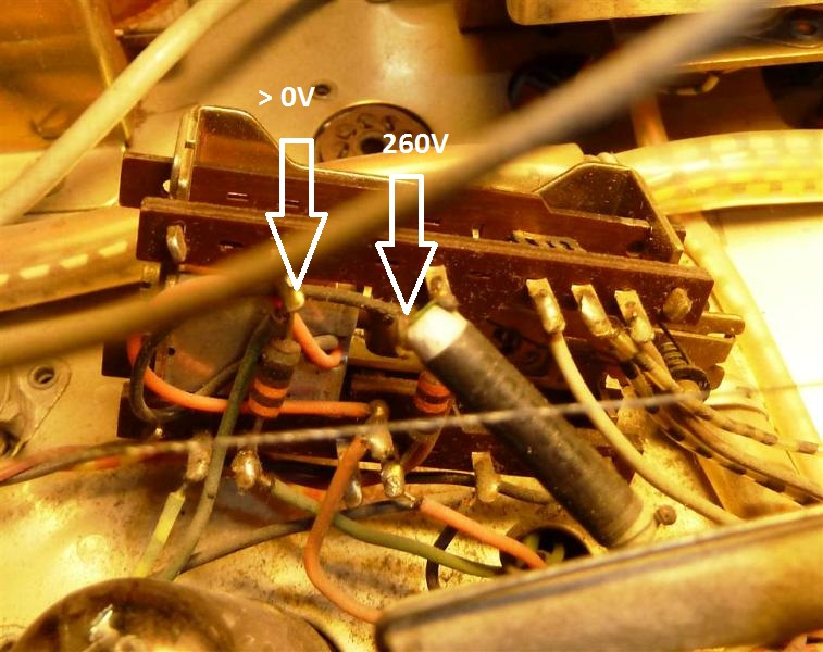

Well - no luck, Achim.....
There is no voltage evident between these two points (I'm assuming that's what you mean?) when the S/M button is pressed. I've also tested from the 260V point to the chassis - still nothing.
So - just as well I haven't dismantled the relay, as it appears to be an "electrical" problem?
Bryan -
OK - getting there!

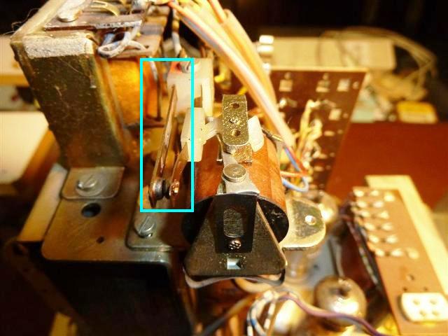

Found the 200uF capacitor (difficult to miss, as it's huge!) removed it and wired in another. No improvement. Put the old one back and refitted the S/M relay and - presto! It worked again. So - somewhere there was a dry joint/ poor connection. I doubt if I'll ever find out where!
Meanwhile the ON/OFF relay is still a bit sticky, so I'm going to have another go at that and then clean all the relays/contacts I can (especially the tuning advance mechanism ) as they all look a bit dirty.
