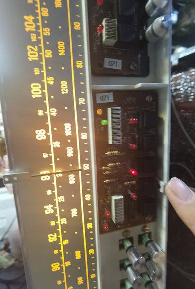

      I asked to push the button FM (button No.9 in the owner's manual) and then tell us, if the FM-LED lights up and you can receive FM.
      Instead, you pushed the button FM-Pilot (button No. 18 in the owner's manual), which is for programming the fm pre-set stations. That is useless at this point.
      You didn't make the photographs of the front after pushing the buttons fm and tape 1, I had asked for. Please make the photographs (total front, please).
      You didn' measure the voltages at the test points J1 and H5 I had asked for. Please measure the voltages.
      You wrote: "Press the fm1-7 button, the indicator will light up, and "it" will automatically turn off in 1 second."
      Again,....what is "it" and which indicator? The LED light of the fm-station button you pressed turns off or all LEDs shut off?
      On the last two photos there is the stereo light on and also the tape 2 indicator light on at the same time. Which buttons did you press and in which order to make these two LED's light up?

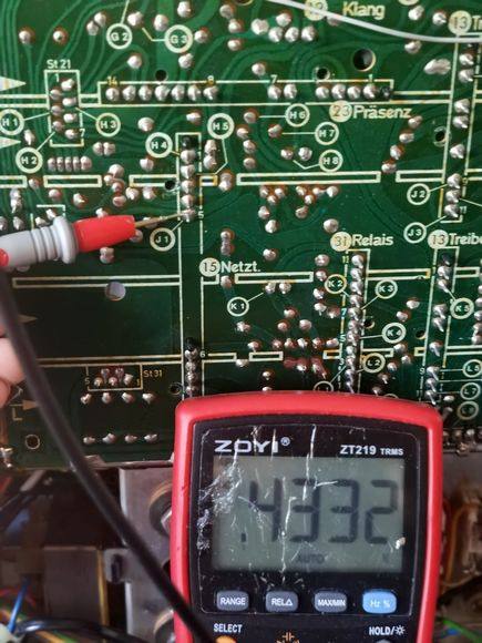

      2. Measure the voltage of test points J1 and H5, there is no voltage, because it is automatically turned off after 1 second after starting, there is no voltage.

      You need to measure the voltages correctly. Your DVM shows "AC" in both cases. That is not correct - you shall measure DC voltage! The display must show "DC".
      Please remove the protective foil from the DVM display glass so that one can read more clearly. The foil is reflecting the light so that your photos are blurred.
      It looks that on J1 you measure 0,43V AC ripple voltage behind the voltage regulator. In that case IC616 would be defective.
      Switch your voltmeter to "Volts DC" and repeat the measurements.
      If you still don't measure the correct DC voltages at J1 and H5 (against chassis ground) the power supply board is probably defective. Upon powering up, voltages are present for 1 second and then break down. Possible root cause could be defective parts, i.e. one of those I am indicating in the following (capacitor has an internal shortage or voltage regulator IC is/are defective or resistor is "open"/became highly resistive):

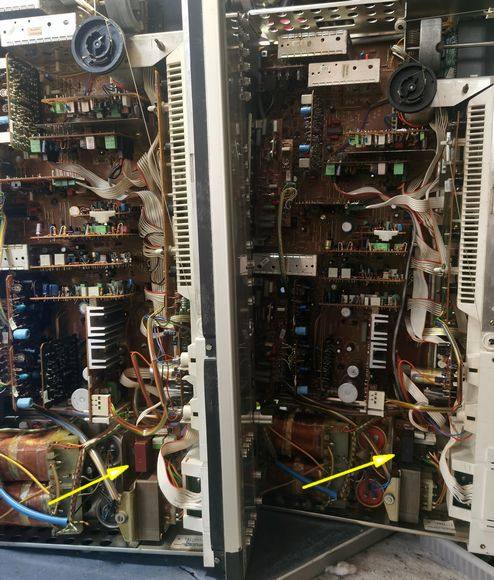

      2. Insert the No. 15 board into the 9141, press the power switch, and then press the FM button, the indicator light will be on, and it will automatically go out for 1 second, and the fault remains, indicating that it is not a problem with the No. 15 motherboard.
      3. I borrowed a 9141 from a friend, and this 9141 is in normal condition. I conducted a comparison check and used the substitution method to replace each of my motherboards one by one on the new 9141. All of my motherboards can start normally, indicating that my motherboards are normal.
      ' data-cke-saved-src=''>

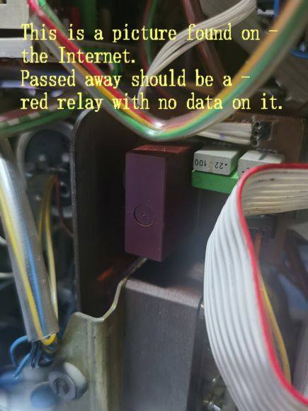

      4. Comparative inspection found a problem. The power relay of the original machine is red, but my relay is black, indicating that this relay is not original, but a relay that has been replaced. Please look at the picture I took. Since there is no data on the power relay, I don’t know if there is a problem with this black relay. Ask the data of the relay. What type of relay should be used instead? I don’t know if the analysis is correct.
      Dieser Beitrag wurde bereits 3 mal editiert, zuletzt von „wyx12007cba“ ()
      The relais you showed is not the original one but has been replaced already (Saba has not used in this model parts "made in China"). Its coil voltage of 24 V DC is correct. The colour plays no role. It is the correct relais on your photo.
      Please measure the coil resistance of the relais. If it is in the range of about 800 Ohm to 1,4 kOhm, the relais is likely working ok.

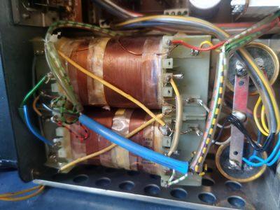

      I checked according to your instructions:
      1. The filter capacitors C2218 (3300 µF) and C2217 (1000 µF) are in normal state and there is no problem;
      2. Insert the power cord into the 220v power supply, and then press the power button to make the LED light up and go out after one second. After the LED is off, measure the DC voltage against the chassis ground on the measuring "K1". The result is that the voltage measured at K1 is approximately 15 V.
      3. Then unplug the power cord and measure the K1 DC voltage again, the result is still 15v.
      Can it be concluded that the power transformer is faulty?
      Definitively not! Its shows that the transformer works ok!
      Please repeat the measurement of the voltage at K1, but after you pushed the fm-button and the LEDs went off, wait 15 Minutes before you measure the voltage. Keep the power cord plugged in. Within the waiting time of 15 minutes capacitor C2216 slowly discharges through module 31 if supply from the main transformer and rectifier is off. It remains charged if supply from the transformer stll continues. After 15 minutes you should measure ...
      ....less than 5V at K1 if the power relais has opened
      ....or still 15V, if the power relay keeps closed.
      Therefore, this measurement will tell if the power relais works ok or not.
      Please report.
      Regards
      Reinhard

      Dear Reinhard and wyx12007cba (this is not your name?),
      sorry for rushing late into this topic but I did not read the thread earlier. You are already quite deeply into the repair process but I did get the powering procedure at the very beginning.
      “2. Press the power switch of 9141 (2 red LED lights near the power switch are on, one of the LED lights flashes), the others have no response and no sound;”
      I have two such receivers in operation and I can’t confirm such behavior.
      If I press the power button labelled “stand-by” only ONE LED (above the power button) does light up (permanently).
      I know only one flashing LED at this receiver which is the indicator for the remote control labelled “IR sensor”. It flashes if you press one of the source or station buttons at the receiver of any key on your remote control.
      Wyx12007cba,
      can you please describe, which 2nd LED light up if you press the power button (the mains cable plugged into the power socket)?
      Maybe this helps to reduce the amount of possible errors.
