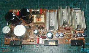

      Hello teachers,
      My 9241 power board has failed. Please help me:
      Fault: The LED does not display. Check the power supply of the ge/sw/rt three pins on the No. 15 power board. The yellow ge-21v, black sw0v, and red rt power supply are abnormal, and the numbers are constantly changing......
      I have checked all the parts on the No. 15 power supply board and have not found the cause of the fault. Please consult all the teachers on how to solve this problem.
      Hello,
      Please show us the solder side of your power supply board.

      From the schematic you can see that you shall check:
      fuses Si621 and Si631
      rectifiers D622 and D632
      capacitors C623 and C633
      relay 618
      You must hear the relay 618 clicking noise, when switching to fm or am. Don't mix up with the loudspeaker relay switching clicking noise, which only can be heard after powering up. The relay 618 must be heard switching always when changing from phono or from band to fm or back.
      A broken relay 618 is quite common. The relay 618 shall be replaced. Since this type of relay is difficult to find today, you may need to build a small adapter board that converts the pin out of a modern relay to the pin pattern on the power supply board.
      Relay 618 data:
      coil voltage: 12 V DC
      two contacts to be closed upon relay switching
      Every relay for 12 V DC operation, coil resistance of about 275 Ohm, and for closing two contacts with at least 2 A current switchable can be used. Example: Finder 40.52.9.012 (12 V DC)

      I agree with Michael. The solder joints of the voltage stabilizers shall be resoldered.
      Otherwise everything looks ok.
      SABA recommended to remove capacitor C624. Maybe there were cases, where it created a short? I never experienced that fault, but nevertheless followed the SABA service recommendation.
      Thus, after all, the relay failure is still the most plausible root cause for the fault.
