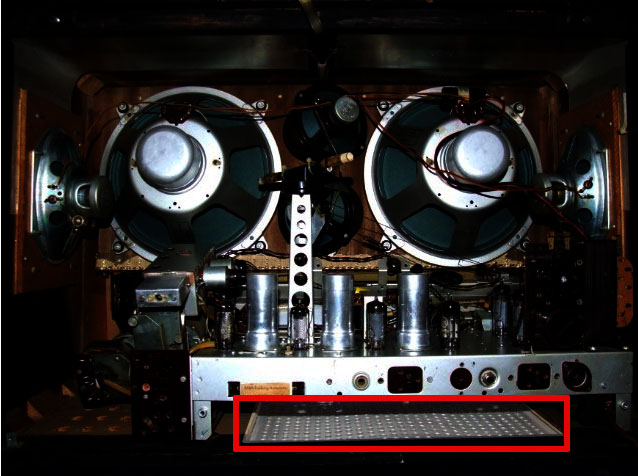

      Included with this radio will be an accurate tracing (drawing) of this missing part, drawn from another 3DS which is in the collection of the seller. Then I can know the dimensions.

      I must laminate some metal foil to the one side of this panel and make a cutting tool to accurately cut the many holes in this metal foil, since the producer of this part can not use his laser to cut the metals and temper board material together.

      No- Not quite yet. Perhaps as the Winter comes, I will bring the little "Unimat" machine to my table and make the special tool for cutting the holes in the metal foil.
