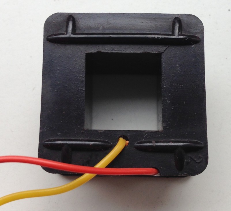

      In the meanwhile I have found the problem: 1 of the 4 coils of the motor have a short circuit to ground, so the bad news is I have a challenge to find another motor for this radio.

      the entire motor should not be easy to get, but a single coil is possible.
      Did you have a close look, where the short ist? May be its at the beginning and easy to repair.

      Hi Dieter, yesterday I removed the "problem" coil.
      As you can see at the picture there is a little crack at the right upperside of the centre of the coil. I think that's the cause of the short circuit.
