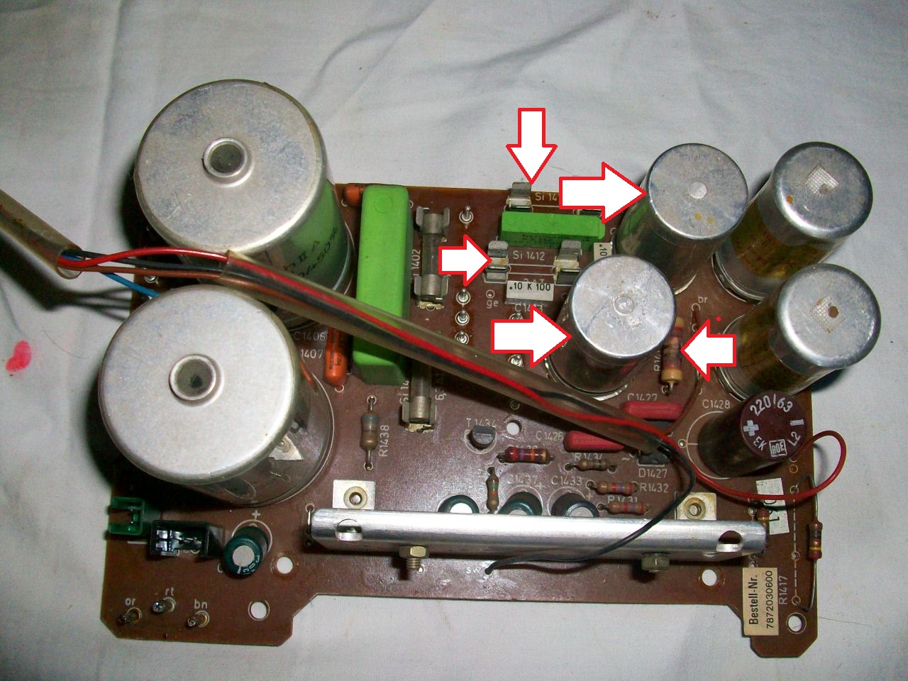

      Hello guys, today is Saturday and we start from here. We begin to repair the power .... We have, in short-circuit, the two capacitors marked with the resistance of 2.2 ohm / 2w. There are two blown fuses 2AT also, plugged into the same circuit. Fortunately, as you can see, there is no reversal of acid. The photo resolution is limited by the load capacity of the server, it is good the same! Thank you all and see you later! Giuseppe Mazzilli from Rome, Italy.

      After Si 1411 and 1412 are blown, i would suggest to check / do the following:
      - Check / replace rectifier D 1427 with a DIL 80 volt / 1 Amp type, the originally built in type is often faulty.
      - Check the resistor 2.2 ohms. This should be a saftey resistor, a combination of a fuse and resistor. Replace best with a 2.2 ohms 0.6 watts metal-film resistor in line with a fuse of about 0.63 amp rating (slow).
      - in any case replace the red Röderstein capacitor C1428 with a good 220 µF / 63 (better 100) Volt type.
      - last check T 1433 / 1434 for shorts.
      Next the other power-line:
      - replace the green "Herrmann" rectifier with a apropriate type. The "Herrmann"s often cause trouble. I think it will have a short on at least one diode.
      - check / better replace the 4,700 and 2,200 µF capacitors with good new ones. If the rectifier was defective, the suffer under the conditions.
      After that is done, replace the fuses and start the power supply board.
      Please let us know about the measurements of the voltages...

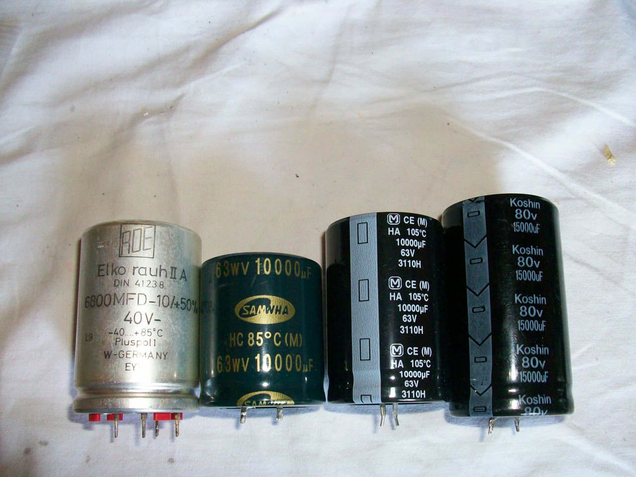

      Now, with the same procedure, analyzing the Saba UHC 9941 we know it has 70w/ch. The Saba 9941 instead has a 6800MF filter, that provides 3 Amps max. The power is 70w/ch Rms, which means a need for about 4.5 Amps = about 11,000 MF. This means that the current produced by the filter capacitor in the period in which the bridge rectifier is not conducting, is JUST suffcient. So what has prompted the German designers Saba to do so? I think simply the problem of space. A capacitor Elko 10.000MF / 40v ( 63v ) would be taller and big to be fitted well without touching, at the top, the plastic support of the Radio tuner. So, I would try replacing the capacitor 6800MF with 15.000MF, if possible. First I have to try it and check if there are any mechanical compatibility of the assembly. Dear Gunnar, what do you think of this? Thanks for the valuable advice you gave me and see you soon !!! Giuseppe.
      Giuseppe Mazzilli postete
      Hello Giuseppe,
      this probably also was a question of money. You must keep in mind that the managers in the developement section had to observe certain budgets.
      The retail price was fixed by the marketprices of the competitors´ products plus SABA had to yield a little Profit also.
      They would have come up with a solution to the space-problem for sure but if a 10.000µF costs € 1,50 more and the budget is exhausted - than that´s it.
      BUT, fortunately today capacitors are cheaper and smaller and we do not have to abide to strict budgets.
      I replaced the 4700µF in my VS 80 and 8120 by 10.000µF myself and didn´t regret it.
      You can keep the original caps in case you want to swap them back some time in the future.

      Comparison test between capacitors :
      Hello Giuseppe,
      i would prefer Achim's advice too. The Panasonic HA is of very good quality, and i think for most situations with 10,000 µF sufficient (I don't think you'll use the set for 24 hours party at full throttle).

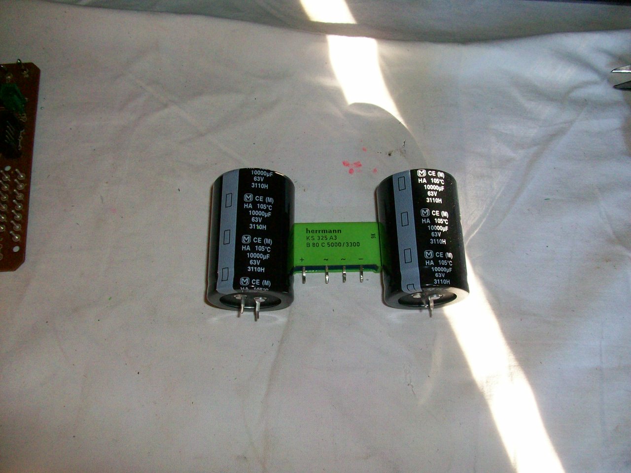

      But if you change the capacitors please be very careful with the big Herrmann rectifier. In my 9241 i changed the capacitors to the next higher value and at the same time i changed the rectifiers. You'll have much higher current in start and the peak current in every wave will be higher. Most of the green rectifiers will not stand that for long (i already had Herrmann rectifiers of that type with a short on one diode too). And it would be a pity if the power supply smokes off some hours after service... Just for safety...
      Hello Achim and Gunnar !
      I agree with the choice of 2 capacitors Matshushita of 10.000MF / 63V. I will apply those. I'll have to change, even if good, the bridge rectifier of + - 35volts. In fact, the bridge mounted is a B80-C5000/3300 type, which means 80volt (max) and 5A (max).
      At this bridge you can apply a maximum capacity of 5000MF = 2.5 A. 2.5 A is the half of 5A, because the other 2,5A will be consumed by the circuit power audio during the conduction of the diodes of the bridge, at maximum volume.
      But already only the circuit draws 5A (maximum volume) then this bridge rectifier, such as capacitors, it is underpowered.
      Maybe the bridge has never been broken because the volume does not rise much during use in the home. But if it is, you can be sure that the bridge rectifier would warm very much!
      I'll have to change with a 10A bridge rectifier and transform the fuse 6.3 AT in 8AT. The fusion of the new fuse 8AT, in case of accidental short - circuit of the power audio line, will be guaranteed because the transformer is a 25Volt / 10A and it exceed the current of the fuses.
