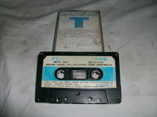

      before moving to the level calibration, I noticed a peculiarity of automatic recording level function ( Alc ). This tape deck has the 0 db VU calibrated to + 3dB conventional reference. The calibration shall be performed at the play level of 580mv on pin 7 of the Dolby Ic for 0db meter reading. This setting must not be so done with test cassette 0db reference conventional (160nw/m, photo 1) but with Dolby cassette test ( which means + 3dB; 200nw/m, photo 2).
      Reference cassette test tape:
      Photo1 :
      Photo2 :
